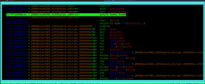

gdb psi
(gdb) run
Thread 8 "QCA::KeyStoreTh" received signal SIGILL, Illegal instruction.
[Switching to Thread 0x7fffe94366c0 (LWP 330287)]
Downloading 35.26 K source file /usr/src/debug/botan/Botan-3.11.0/build/include/internal/botan/internal/simd_4x32.h
0x00007fffe858bc1c in Botan::SIMD_4x32::splat_u8 (B=15 '\017') at build/include/internal/botan/internal/simd_4x32.h:146
146	         return SIMD_4x32(_mm_set1_epi8(B));
(gdb) layout asm
psi_botan.jpg Изображение
botan - собран с не поддерживаемыми инструкциями.
